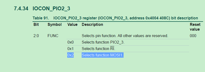

Hi Luuk Grefte,
   Your pin function configuration is not correct, please check the user manual. I have checked it, SPI function in PIO2_0, PIO2_1, PIO2_2, PIO2_3 is all function 2.

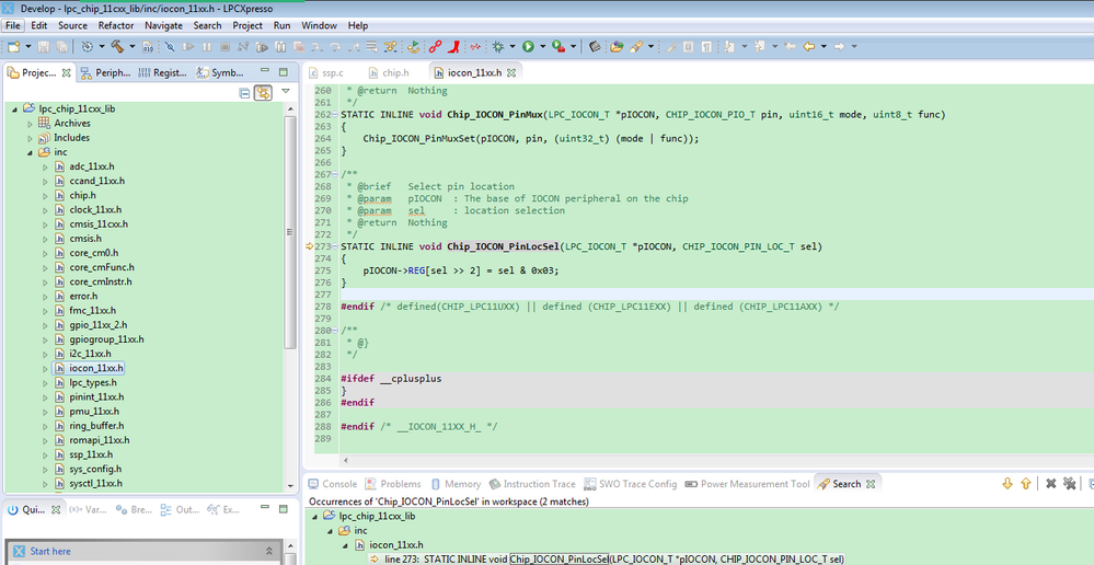

   Take an example:
Chip_IOCON_PinLocSel can be found in iocon11xx.h, in the lpc_chip_11cxx.lib.
Please modify the pin function to 2, then try again.
