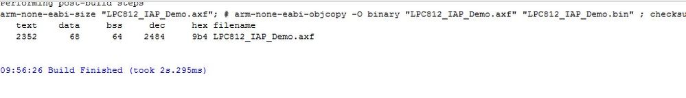

Hi Jeremyzohu,,
the address 0x1000 is the address proposed by the demo, but I've also tried other address like 0x2000 with same
results.
Moreover, if I see the bin size is 0x9b4 then 0x1000 is a free area.
What tool have you used for view the memory footprint? I've ever used the memory view but only when I'm in debug mode.

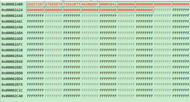

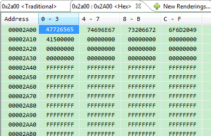

Hi Fabio,
I've run the demo on the LPCXpresso 812 MAX with two kinds of IDE: KEIL and LPCXpresso.
It both can works well.
In my testing, the address is changed to the 0x2A00.
Using the LPCXpresso:
1. In the firstly cycle , enter the debug mode.
2. Enter the debug mode after re-power the board.
And the same result is happen when using the KEIL.
Hope it helps.

jeremyzhou
Hi Fabio Benevento,
I think I'm clear with the issue: the written value will disappear after you return the debug mode no matter keep power persistently or not.
The 0x1000 area is occupied by the demo, in another word, the area will always be erased and programmed when enter the debug mode.
Hope it helps.
Ping
