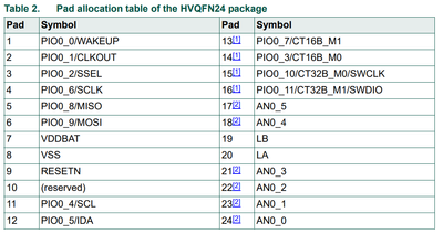

We have a custom board with the LPC8N04, and we are programming it with a Keil ULINK2 programmer via the SWD interface. At this moment, the MCU is in DeepPowerDown mode, and I can't reach the core anymore with the debugger.
How can I program the LPC8N04 again?

Deep sleep modes are known to break debug access.
I suppose it would help to add a wake-up source than can be manually operated, like a GPIO level transition.

It seems you are right, I couldn't find anything mentioning mode pins or ISP mode.
Which is somewhat unusual.
Perhaps some NXP employees can explain how to unbrick a board with this MCU.
I would try to set the wakeup pin (PIO0_0) and attempt debug access at the same time.

I am not familiar with this chip. But pulling RESETN low would usually take a CPU out of low-power modes and into some sort of reset condition.  Maybe try if it responds to SWD commands while under reset that way?  It would be unfortunate if you had to release reset and then do SWD in the next few microseconds, before too much code had executed, to bring it back into low power mode.
