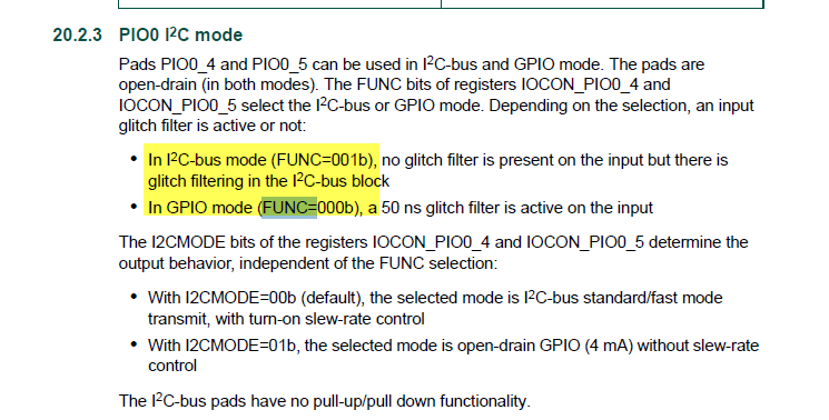

I developed my project with LPC8N04, and I got LPC8N04-MCUXpresso-BSP.zip from NXP. There are only I2C and SPI API in this package.
Could anyone show some demo code(init , read/write) for using I2C and SPI in LPC8N04 ?
For example I don't know what is mean IOCON_FUNC_0(0,1,2....) in Chip_IOCON_SetPinConfig(LPC_IOCON, (IOCON_PIN_T)0, IOCON_FUNC_0 | IOCON_RMODE_INACT); and how to set SCL and SDA pin.
Thanks.

Hi Simon,
   Yes, now we just have the according driver for lpc8n04, we don't have the detail peripheral sample code for I2C and SPI now.
   IOCON_FUNC_0, just set the pin function, The FUNC bits in the IOCON registers can be set to GPIO (FUNC = 000) or to a peripheral function.
    If you want to use the according pin as I2C, you must configure it to I2C function, not the GPIO function.
    When you send the data, do you check the I2C bus wave, whether the bus wave already have the I2C data, and just the 9bit don't have ACK? The 9bit ACK is given by the I2C slave.
   So, please also check the I2C bus wave.
Kerry

SimonZhang
Hi, Kerry
Thanks a lot.
I don't know why there are nothing in
void Chip_I2C_EventHandler(I2C_ID_T id, I2C_EVENT_T event)
while (*stat == I2C_STATUS_BUSY) {
And I add process as:
if (Chip_I2C_IsStateChanged(id)) {
Chip_I2C_MasterStateHandler(id);
Then IIC worked.
It is different between Chip_I2C_EventHandler and Chip_I2C_EventHandlerPolling,
Regards.
Simon

I init I2C as:
Chip_IOCON_Init(LPC_IOCON);
Chip_GPIO_Init(LPC_GPIO);
Chip_I2C_Init(0);
Chip_I2C_SetClockRate(0,I2C_BITRATE);
and set pin as:
Chip_IOCON_SetPinConfig(LPC_IOCON, (IOCON_PIN_T)4, IOCON_FUNC_1 | IOCON_RMODE_INACT);
Chip_IOCON_SetPinConfig(LPC_IOCON, (IOCON_PIN_T)5, IOCON_FUNC_1 | IOCON_RMODE_INACT);

SimonZhang
continue:
Then I try to send something by:
Chip_I2C_MasterSend(IIC_8Nxx_ID,0x44,read_vol,4);
but i2c was stuck  in
Did I miss something in init?
Thanks.
