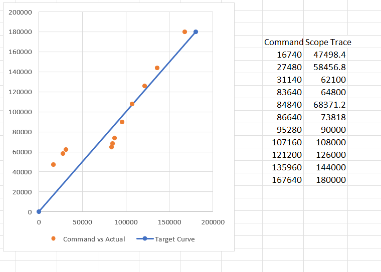

I am using the MRT to generate a fixed pulse on a GPIO output. However, depending on the command INTVAL the MRT timer has a longer or shorter interval actually being revealed.
The core is running at 60MHz. When the timer is loaded with anything above 15,600 the actual output as measured on a scope on the GPIO output is 246 us longer. When the INTVAL is loaded with anything below 15,000 the output is 7 us shorter than expected. It's a consistent offset 15,600 or 600,000 all is 246 us longer than expected.
Here's the code launching the MRT timer:
void mrt_Launch(uint32_t val)
    val = 60 * (val);
    MRT0->CHANNEL[0].INTVAL = val | MRT_CHANNEL_INTVAL_LOAD(0b1);
    MRT0->CHANNEL[0].STAT turnon MRT_CHANNEL_STAT_INTFLAG_MASK;

I've attached an image of the chart of measured vs command MRT timer interval in another test. There is a marked step around 64,000 ticks. It's not 65535, but it's awfully close.

rmaier
Hello Miguel,
The problem has been resolved. I discovered a spurious interrupt that was launching another MRT event. Since it was overlapping it wasn't immediately evident on the scope trace. Root cause: User error.
