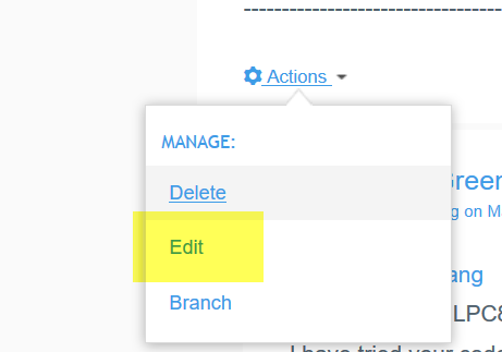

Hello Philip Green ,
Please refer to the steps below attach your project and file, thanks.

Hello UK,
 Ok, could you please attach your whole project from "Action" as below:
