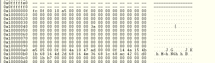

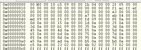

3c. To my suprise, the copied value is the bottom of bootROM ! But the intvec in 0x00000000 is correct :

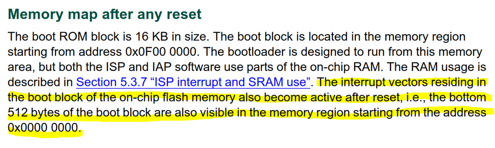

4.It seems like something went wrong when the debugger is attached, according to the manual boot block is also visible at 0x00000000, maybe the mcu believed the last 512 byte of bootROM is intvec and hardfault happened when an exception is raised, since it can't find the handler address hardfault is raised and PC went to 0x00000000 ?
