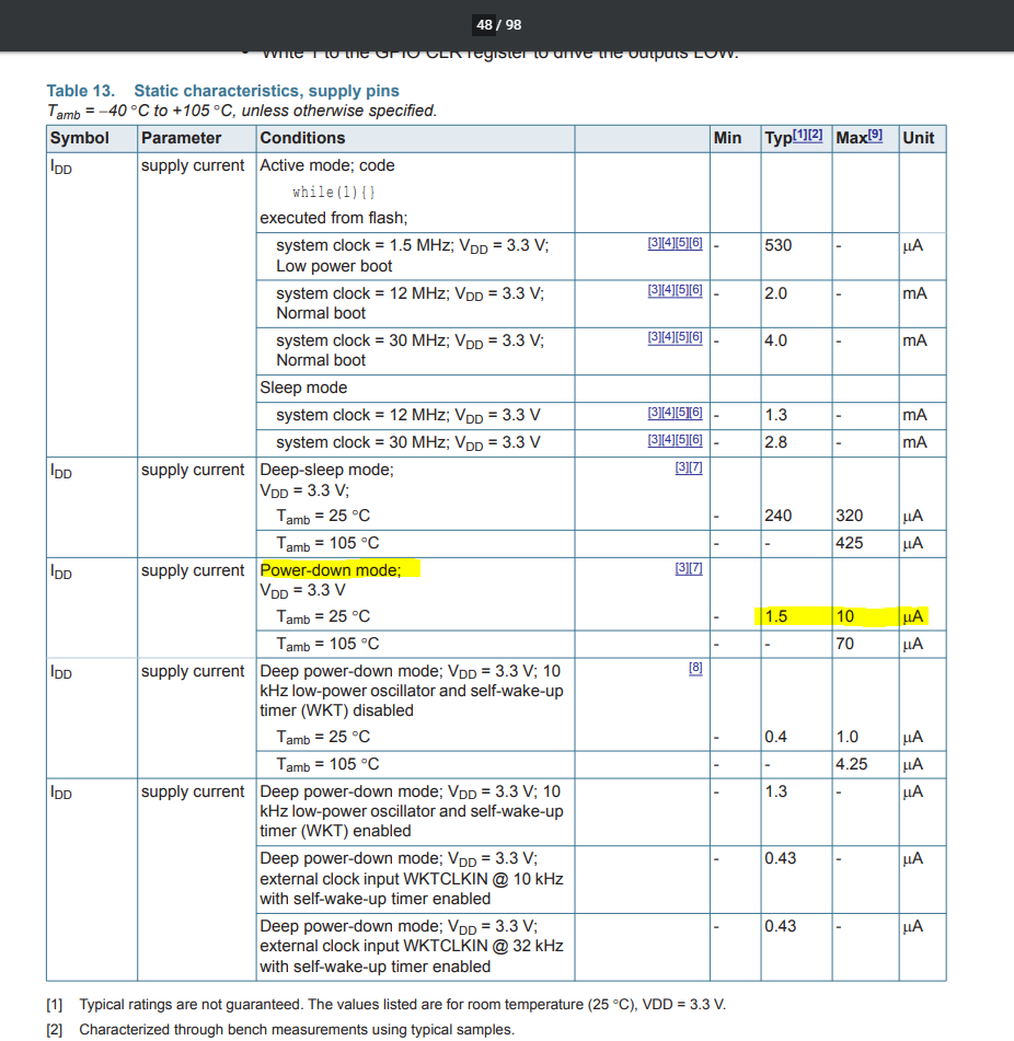

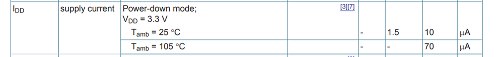

I'm trying to reach the current stated in the datasheet of the LPC845 in power down mode.pastedImage_2.png
I'm working at Tamb = 25°C, Vdd = 3.3V, QFN33 package.

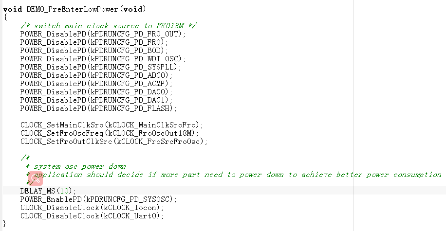

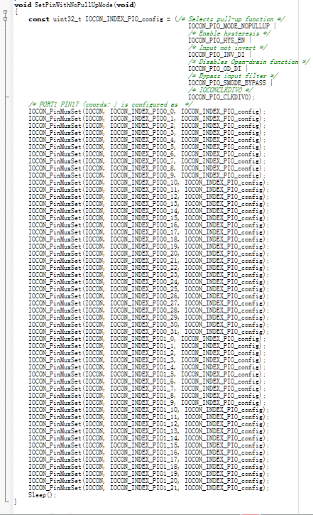

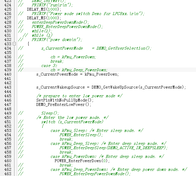

phidiawang
  • I have solved this problem, please see the attachment

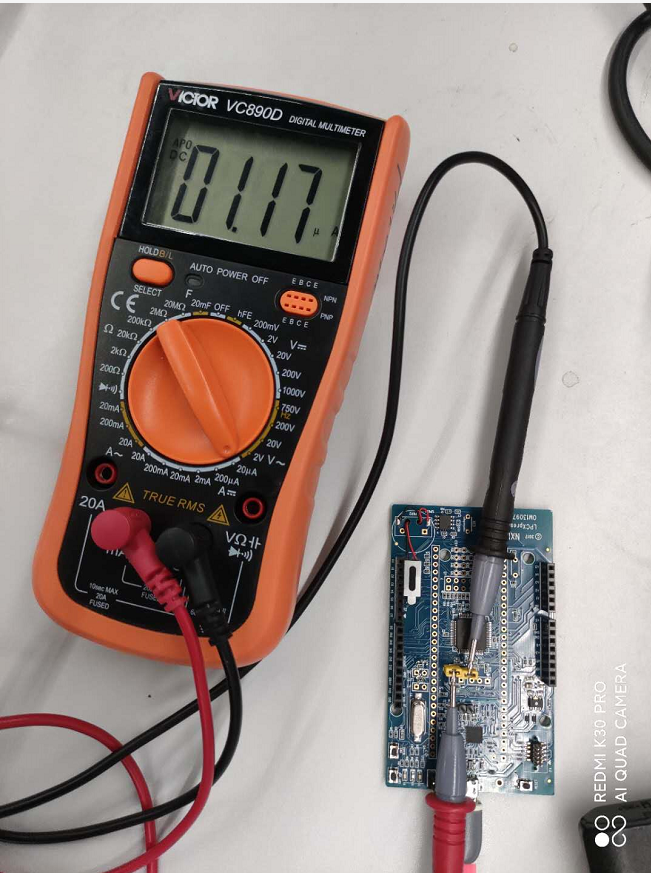

phidiawang
I tested  it again(LPCXpresso845MAX),it's 1.17uA.
I disconnected the SJ6,and concatenated the multimeter between 2 pins of  JP2.
5,492 Views

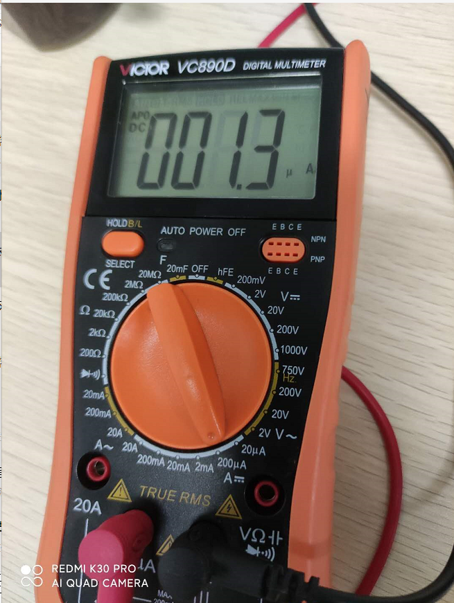

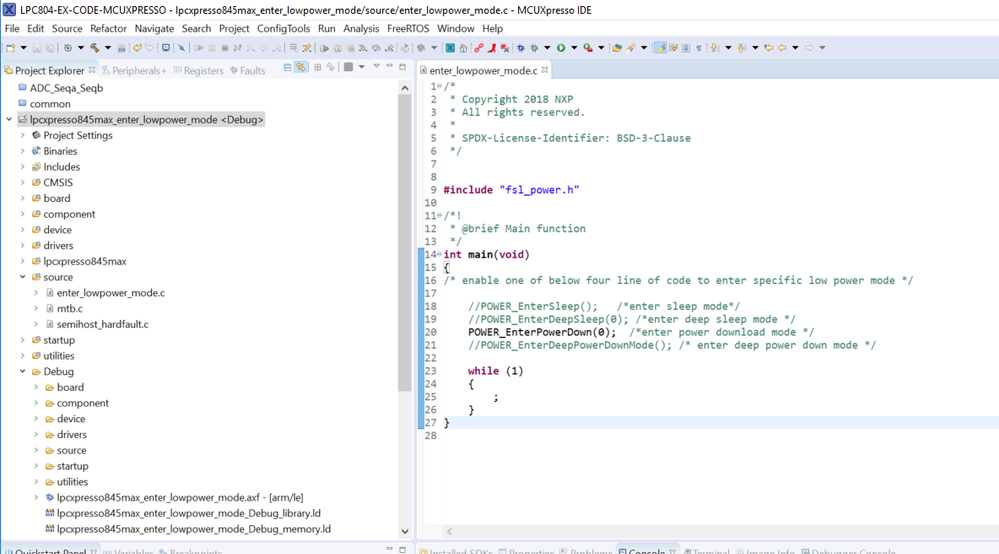

ZhangJennie
I tested it again.
I think the key issue of getting 43.6uA in power down mode is that IDE is interactive with LPC845 via SWD background, LPC845 debug module was not fully power down. I just tested below code on demo code (very simple):
after downloading code, disconnected power supply, then powered on board again. the current went down to 1.5uA:
Jun Zhang
5,492 Views

v_canoz
Ok, but what modifications do I have to do in the code, in order to be able to reach the current stated in page 48 of the datasheet ?
Power-down mode states 1.5µA typ current at 25°C...
