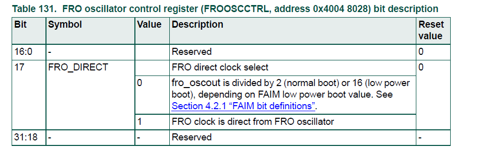

This is a snippet of 845 SDK :
I can't find any information about [1:0] bits of FROOSCCTRL register in the user manual.
These data are confidential ?

Hi Lajos Toth,
These bits are set in the set_fro_frequency() API, this function is located in the boot ROM. In the SDK you can found it with the following name and the argument helps you to modify the output frecuency:
 CLOCK_SetFroOscFreq(kCLOCK_FroOscOut18M);   /*!< Set up FRO freq to 18MHz */
 CLOCK_SetFroOscFreq(kCLOCK_FroOscOut24M);   /*!< Set up FRO freq  to 24MHz*/
 CLOCK_SetFroOscFreq(kCLOCK_FroOscOut30M);   /*!< Set up FRO freq  to 30MHz*/

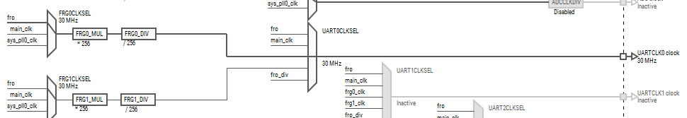

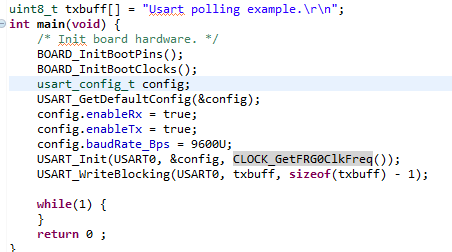

Thank you Alexis Andalon for your answer. The reason of my question was that I have trouble with get clock functions.
I created a simple USART project transmit data to VCOM port:code.PNG
This is clocks diagram of USART0:frg0.PNG
If I change CLOCK_GetFRG0ClkFreq() to 30000000U the usart works well, but the function returns  wrong value(13222784)

I am not confusing with clocks,  CLOCK_GetFRG0ClkFreq() call CLOCK_GetFroFreq() function if the clock source for FRG is setting to FRO. The problem is solved, there is a type casting bug in CLOCK_GetFRG0ClkFreq() function as well as in FRG1.
