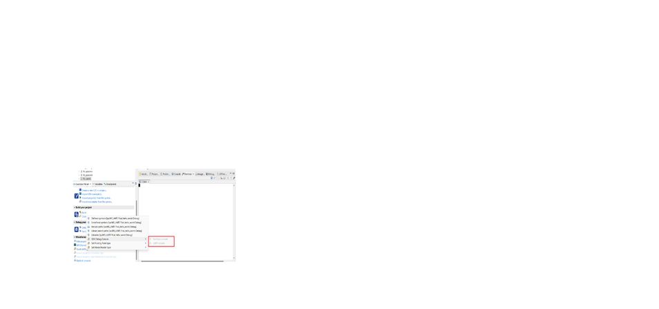

Mr_Damian
Hi Alice,
The options is not available for me, I'm not sure why ?
Best
Damian
2,115件の閲覧回数
Hello @Mr_Damian
Please checked your project.
Alice

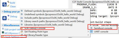

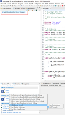

Hello @Mr_Damian
Do you use MCUXpresso IDE? Maybe it print to UART port, change SDK debug Console to "Semihost console" as below:
Alice
