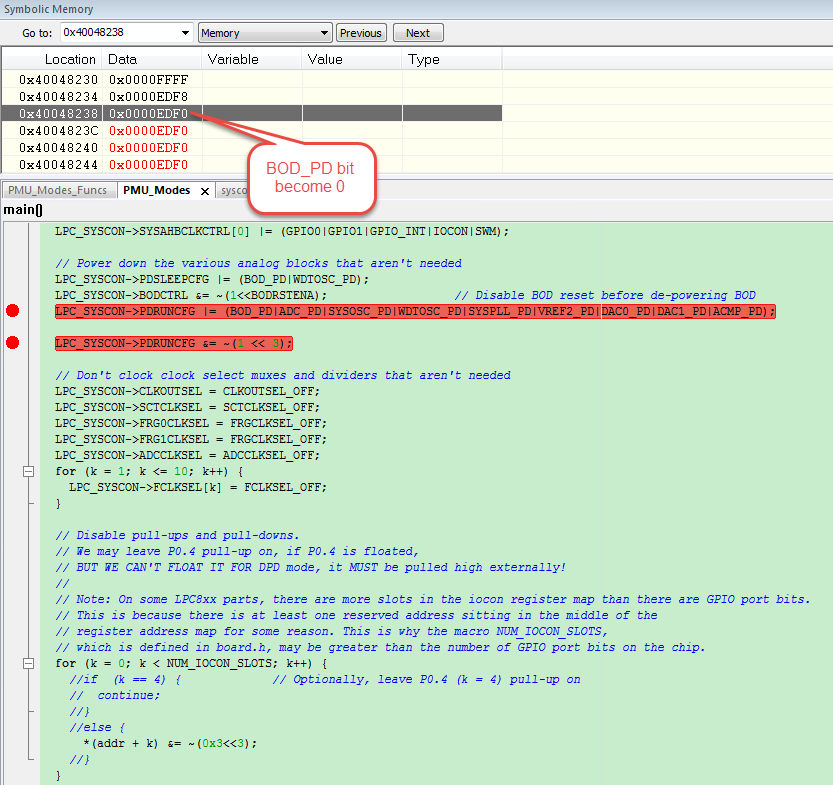

jeremyzhou
Hi Helder Parracho ,
Sorry for reply late.
The phenomenon doesn't happen when I debug the PMU_Modes in IAR IDE with LPCXpresso 845 board, the BOD_PD is allowed to set 0 as the Figure1 indicates.
I was wondering if you can share a compile-able demo, then I can replicate the issue on my site directly.

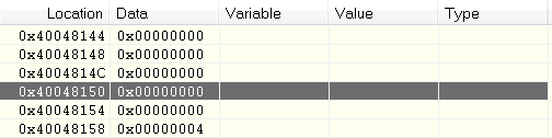

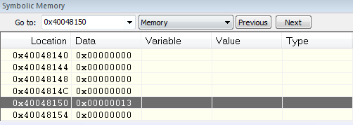

Actually, the reset value of BODCTRL is 0x00 just as the RM states.
In my testing, the LPC824 will became 'brick' when enable the reset function without the wait loop, and it spend me a lot time to recover the 'brick'.

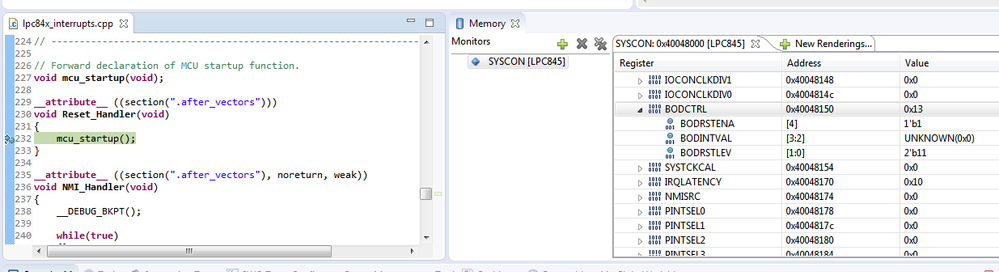

hparracho
Hi jeremyzhou‌,
Thanks again for your reply.
You have confused the microcontroller. I am referring to LPC845 and not LPC824.
I am sorry to disagree with you but, as you can clearly see from my print screen, immediately after reset, the LPC845 BODCTRL register starts with the value 0x13 and not 0x00.
What I get from your answer is that the wait loop is needed (apparently not only on LPC845), still this is undocumented.

jeremyzhou
Thanks for your reply and I've run the deo code with LPCXpresso 845 MAX board.
According to the testing result, the reset value of BODCTRL should be 0x13 as you mentioned before.
However I can reeable the BOD reset feautre without the wait loop after power up.
