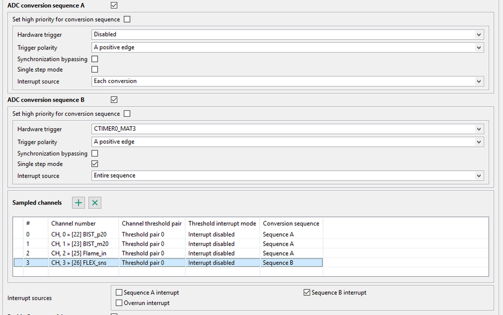

I am using LPCXpresso845MAX kit.
I want to Verify Amplitude and Frequency of 60Hz Sine Wave through ADC.
I am planning to Use ADC with CTIMER0_MAT3 Hardware Trigger (Match 3 channel of CTIMER0).
I have configured ADC channel 3 in Sequence B and other ADC channel (which are software triggered used for other purpose) in Sequence A.
And configured CTIMER with 0.16ms timer interval. (100 ADC sample for 60Hz(=16.66ms) period)
But I am not getting ADC Sequence B Interrrupt.

Hi Ritesh Panchal ,
for the opportunity to serve you.
I'd like to suggest you'd better go through the generated code firstly, maybe you can find something miss.
In addition, the post (DMA Ping-Pong application ) presents how to use the SCTimer to trigger the ADC to start a conversion sequence, it may give you some insight.
