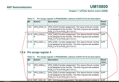

This is the spi connection between slave spi of LPC82x and master spi.
Master         slave
MOSI ---------> MISO
MISO ---------> MOSI
SCK ---------> SCK
GPIO   -------->any port pin for example PIO0_10
You have to use the code to configure the sselx pin.
SWM->PINASSIGN[4]|=0xFF00FFFF;
SWM->PINASSIGN[4]|=0x0A0000;
Then the PIO0_10 will function as slave spi SSEL pin.
