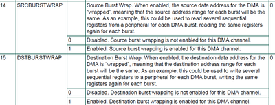

I am trying to generate a complex PWM using two SCT channels. They have to be synchronized so I am using MATCHREL[1] and MATCHREL[2], and DMA to load the new values sequentially from memory per trigger - this seems to work perfectly for a single register, with DMA0_CFG register set to BURSTPOWER = 0, and no wrap settings (SRCBURSTWRAP and DSTBURSTWRAP set to 0).
However, with BURSTPOWER = 1 (2^1 transfers), DSTBURSTWRAP  = 1, and DMA destination set to MATCHREL[1], two transfers occur, but as far as I could verify only MATCHREL[1] is written twice.
Are there any limitations on the behavior of DSTBURSTWRAP? I assumed that it would use the WIDTH value of the XFERCFG register and increase the destination accordingly, resetting once the burst was completed, but this doesn't seem to be the case. How is the transfer width of the sequential writes decided?
On that note, how does XFERCFG DSTINC value affects DSTBURSTWRAP? With DSTINC set to a value different from 0, I know that at least it writes sequentially to addresses but the wrap functionality goes ignored (as far as I can reason) - at the very least i know it writes to MATCHREL[3] since that controls a different subsystem.
Here is an snippet for the current DMA settings (uses old LPCOpen nomenclature) -  as stated above, to me the end result is double writes to MATCHREL[1]:

For your case, you can choose not use "Burst Wrap" function.
Just config  BURSTPOWER 0001: Burst size = 2 (21).
config SRCINC to 0, DSTINC to 0x1, WIDTH to 0x02.

With TRIGBURST set to 1, both SCT_OUT1 and SCT_OUT2 should have the same output. But in this case, SCT_OUT2 remains high as set in setupSCT(). Changing DSTINC to 1 does make both SCT_OUT1 and SCT_OUT2 have the same output, but SCT_OUT3 is also affected (so I assume the DMA is just increasing destination address without wrap).
My goal is simply to transfer the content of scandata[], two writes at a time, to a set of consecutive registers. I can probably manage to do it with two independent DMA transfers but I would like to know why TRIGBURST fails in this case.

Yes, when set DSTBURSTWRAP to 1, meaning that the destination address range for each burst will be the same, not change, for your case, it is  MATCHREL[1].
How about set SRCBURSTWRAP to SRCBURSTWRAP 1, and config  DSTINC  to1.

Considering BURSTPOWER = 1 (2^1), then each triggered transfer with SRCBURSTWRAP = 1 will have scandata[0] and scandata[1]. This is what I understand when the documentation says When enabled, the source data address for the DMA is “wrapped”, meaning that the source address range for each burst will be the same. I am also assuming "range" is a sequential set of addresses/registers. It is also not clear if SRCINC should be set to 1 or 0 for SRCBURSTWRAP to have the expected behavior.
That is also the equivalent of one of my original questions : If DSTINC is set to 1, will this mean the destination address wrap is performed or ignored? Is it part of the "range" calculation at all?
I would be happy to see an example where the destination address range for a burst is a sequential set of registers (in my case MATCHREL[1] and MATCHREL[2]).
