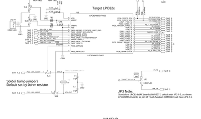

I have a LPC824_Xpresso  board OM13071 and I would like to output on P0_27 (blue led on the board) the clock produced by the system oscillator.
Firstly I moved the SJ3 and SJ4 to pin 1

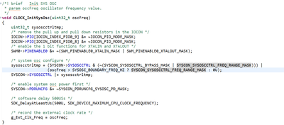

Since I would like to understand properly how the registers work, I wrote this function
void output_XTAL(void){
/* power IOCON*/
SYSCON->SYSAHBCLKCTRL|=((0x1<<7) | (0x1<<18));
/* Crystal Oscillator (SYSOSC) setup */
IOCON->PIO[8]&= ~(1<<3)|(1<<4); // remove pullup and pulldown resistor
IOCON->PIO[9]&= ~(1<<3)|(1<<4);
SWM0->PINENABLE0&=~(1<<6)|(1<<7); // XTALIN XTALOUT pin enabled
SYSCON->SYSAHBCLKCTRL&=~((0x1<<7)|(0x1<<18));
SYSCON->SYSOSCCTRL=0x0; // disable the bypass bit
SYSCON->PDRUNCFG &= ~(1<<5); // power on SYSOSC
for(volatile uint32_t i=0; i<200; i++) __NOP(); /* wait */

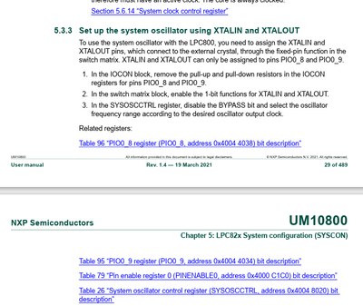

However I do not get the SYSOSC clock on  PIO_27. If I try to have the IRC oscillator on the same output pin simply changing this SYSCON->CLKOUTSEL=0x0; ....it works.
Do you know why? I am basically doing the operations described below when setting up the SYSOSC

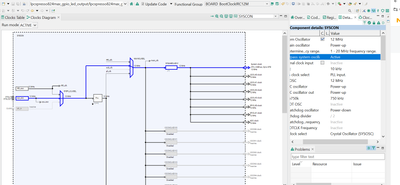

Hello @topspin
How about use Configure tool inside MCUXpresso IDE to config the system oscillator and pins.
Then generated code.
Alice
