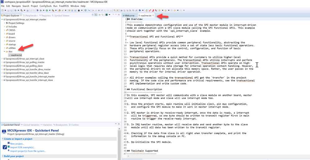

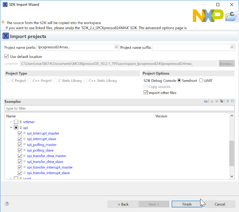

Select all spi examples and click Finish in order to import to the workspace.
After do that, you can find a readme document under doc folder that you can use as reference.
I hope this helps,
Sol

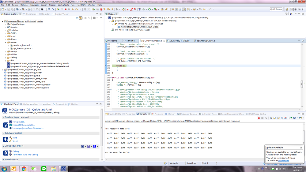

   i has already download 2 evm with SPI_Interrupt_Master ( Debug Mode ) & SPI_Interrupt_Slave ( Free RUN )
   but transfer date fail , what is happening ?
   i need you suggestion to solve this and i can keep going my application , thanks a lot !!
