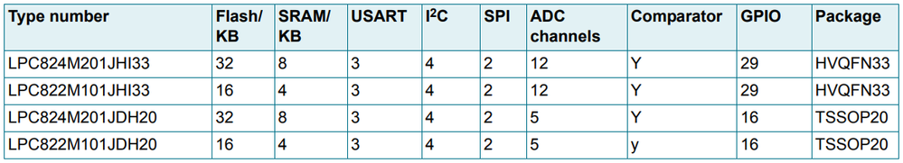

I'm looking to substitute LPC824 for LPC822, but I want to be sure everything will be compatible. Are there any other differences between them besides Flash and SRAM size?

Yes, these devices are compatible only Flash and SRAM size differences.
