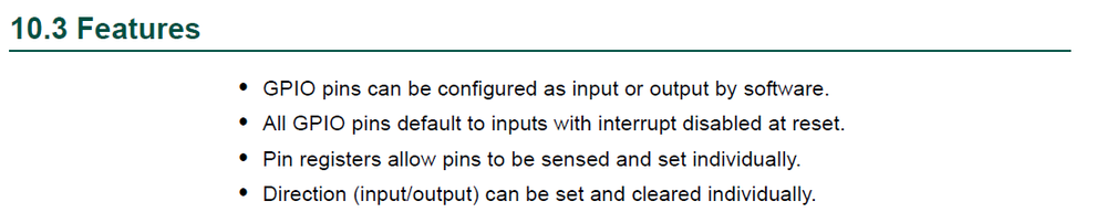

Then I erase MCU flash and measure idle pins waveform, which are also output pull-up. This is different from the description in the user manual, all GPIO pins default to inputs at reset.

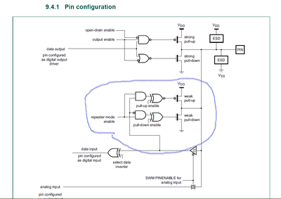

As the following pic I copied from the UM11065.pdf, during/after Reset, almost all pins are in GPIO input state with on-chip pull-up resistor enabled, that is why you see high logic for the PWM pins during/after Reset before you initialize the pin.
I suppose that you have to connect external 5K~10K ohm pull-down resistor for the PWM pins, this is common practice in order to keep the PWM pins low.

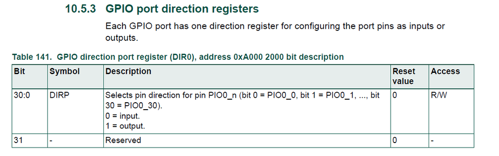

Thanks for your answer, but I'm still a little confused.  the following pictures I copied from the UM11065.pdf. If the port state is an input state at reset, the port internally internal circuit is connected to a Schmidt trigger, it will be a high resistance input state and should not have a pull-up level output. Why does the port direction have a lower priority than the output state?

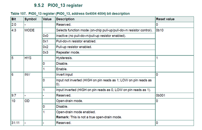

As the following pic I copied from UM11065.pdf, when the weak pull-up is enabled, the pin will be in high logic. when the weak pull-down is enabled, the pin will be in low logic. Unfortunately, in default, the weak pull-up is enabled, the pin is in high logic as you have observed.
You have to connect an external pull-down resistor(5~10K ohm) to the pin so that the pin is in low logic.
