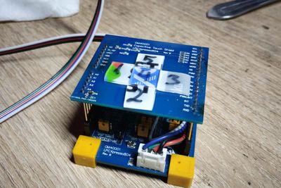

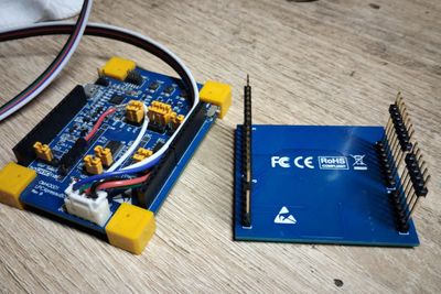

This is what I'm currently doing:
The device will need to work under a sticker, so that's what I'm simulating. I also have I2C attached.
I also replaced the pins with longer ones. Would that make a significant difference?
You will also notice that I switched one of the lines (YH/ACMP_14). I reassigned them in the mux, of course. I needed P0_7 for a different purpose here (the extra red cable) and it was the most immediately available to me. The capacitor was replaced with an identical value on the ACMP_14 line (where the DNP resistor would have gone).
