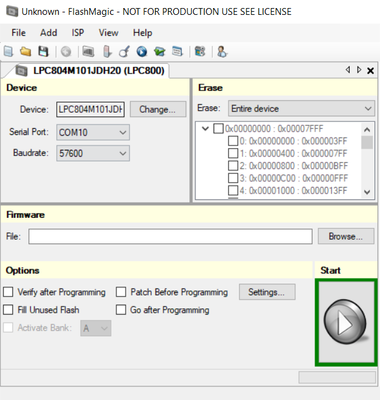

Hello phatpaul,
There is really some different with other LPC chips when enter ISP mode.
We need always press the ISP button. I test on my side, it works well, please see my attachment.
Please try on your side, if still can't work, update the firmware of on board debugger lpc11u35, about detail refer to:
https://community.nxp.com/t5/LPC-Support/Update-the-firmware-of-the-LPC800-via-ISP-mode/ta-p/1105041
Alice

Hello phatpaul,
How about use the function in GUI of Flash Magic?
Alice

Hello Paul,
I meaning use the buttons on GUI, not command , I will test on my side tomorrow.
Alice
