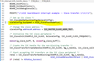

I perform some tests with the LPC804 as a slave and the LPC54628 as master with the bus speed at 400kHz.
In the slave, I added this line, if this line is not added the slave will not respond to the master
Since I was doing a board-to-board communication I did not add the pull-up resistors since they are internally in the pins. Having a common ground between both devices is suggested.
Let me know if adding this line in the slave solves your problem, if you have more questions do not hesitate to ask me.
