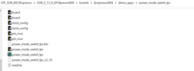

    I'm using LPC804 33PINS, trying to enter deep sleep. I'm used PINT interrupt concept P0_18 to enable from deep sleep mode. But i could able to wake from deep sleep. Kindly resolve this issue

Pls download SDK package from the website:
https://mcuxpresso.nxp.com/en/welcome
There is an example power_mode_switch_lpc
In the example, the PIO0_13 pin is configured as the PIN0 triggering pin, you can change it as PIO0_18 as kSYSCON_GpioPort0Pin18ToPintsel .
Hope it can help you
