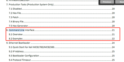

ZhangJennie
Hi shai_b
we can find sample in FlashMagic manual
Hope this helps,
Jun Zhang
