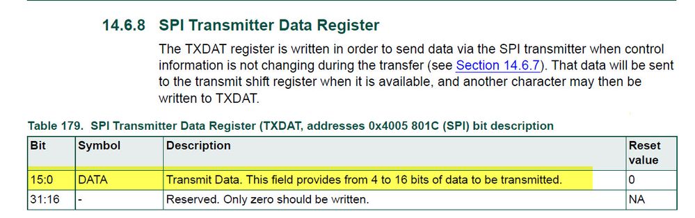

As the Data transfer Length is setup with 8 bits width, so RXDAT and TXDAT will be handle each single byte. but why does it need casting type (uint16_t) as below?
I have connected to external SPI chip (AS3933), if no casting type, then read command sometime did not get right value.

Hello Babycat,
- TXDAT is 32 bits register, while the 31:16 are reserved, only 15:0 is  DATA part.
-"what could be the difference btw:
TXDAT = 0xFF
and
TXDAT = (uint16_t)(0xFF) = 0x00FF
To some machine, when there is no casting, maybe add random data in 15:8, for example 0x10FF, not 0X00FF.
So for rigorous,all the data put to DATA need casting to 16 bits.

Hello Babycat,
Because the DATA in SPI transmitter data register is 16 bits, so no matter the
data transfer length is, we need (uint16_t) as you said.

TXDAT is a 32bit register,
TXDAT = 0xFF
and
I am not so clear why casting does its job there? I might be missing something...

Hello Babycat,
TXDAT = 0xFF
and
Alice
4,039 Views
Babycat
 Hi Alice
Oh, I understood. I did not know about that, I thought C complier will auto add that extra 00 as its job supposed to.
