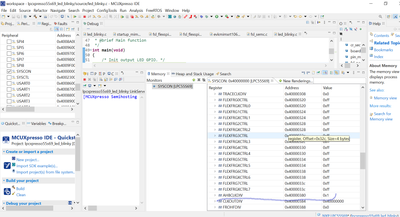

On the device I am working with, the reset value is 1 (All the AHB peripherals work at half the speed of the main clock.
The manual says that the reset value is 0 (Peripherals work at the clock speed)
Is this another one for the errata?
1,520 Views
xiangjun_rong
Hi, Ian,
Yes, I agree with you, the default AHBCLKDIV is 1 after Reset.
I will report the doc error to AE team so that they can modify it in the next version of UM.
Thank you for reporting the error
