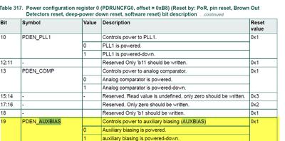

Hello ianbenton,
 AUXBIAS is ADC analog references, by default it is power-down, if want to use ADC, we need power it.

Hello ianbenton,
The "enum pd_bitsf" is showing which analog peripherals can remain running and therefore can wake up the chip from deep-sleep. No relationship with ADC configuration.
Sorry please ignore the first screenshot at my last reply, just refer to
Table 317. Power configuration register 0
Table 319. Power configuration clear register
I also don't  think the description in UM is clear, so recommend refer to SDK demo.

ianbenton
Senior Contributor I
So, I cleared bit 19 (AUXBIAS) of PDRUNCFG0, and now it works.
There's no reference to AUXBIAS in the ADC section of the manual, and no reference to AUX BIAS in the ADC set up and driver software in the SDK.
There only reference to what AUXBIAS does was in table 335.
