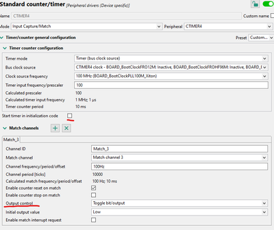

ianbenton
Senior Contributor I
Write HALF the cycle time to MR3 and MST3
Set bits 10 and 27 in MCR to make it reset and reload.
Set bits 10 and 11 of EMR to make it toggle on match (that’s why you need half the cycle time)
Set bit 0 of TCR to make it go.
then set bits 0 and 24 in TCTRL5 in the A/D to make it trigger from input 5 and run command 1.
if you need an interrupt when it has finished, set bit 21 of IE
in the A/D, set bits 0 and 24 of TCTRL5 to enable the trigger from input 5 and run CMD0 ( or whatever command you want it to run)
if you want an interrupt when it has completed the conversion, set bit 21 of IE.

Dear @ianbenton ,
Thanks for confirming that configuring external match register (EMR) to toggle the output bit (EMR[EMC3] = 0x3) will effectively double the cycle time. That's exactly how I configured the timer. I was unsure about this as it has been recommended to set the output bit instead. But then you need to reset the bit somewhere (e.g., ISR) manually.
Further, I noticed that the FIFO overflows while single stepping during debugging. This also created perpetual irqs (as I had enabled fifo overflow interrupt but not yet handled it in my code).
I think I'm getting there

This won’t help you at all, but I corrected the gormless mistake that I made in calculating the cycle length!
3,933 Views
danielholala
Senior Contributor II
You are right.
And I should make sure to read out the FIFO completely in ADC ISR.

Hi @ianbenton ,
I have the same application in mind but I'm struggling to get CTIMER to trigger ADC. If I understand the user manual correctly, ADC conversion can be triggered by CTIMER directly. With "directly" I mean, that the trigger mechanism is done in hardware and not implemented in software (by writing a timer ISR that writes to ADC register SWTRIG to generate a software trigger). Could you please provide your configuration?
For your information, I have CTIMER configured as follows using Peripheral Tools, see screenshot below:
Note: I start the timer manually in my code. The timer is running as I can see that the TC register is running.
Do I have to select an "output control" and do I have to route the output to an actual pin? I assume that "Toggle bit" means that the actual trigger rate is reduced by factor two as the "hardware trigger events are detected on the rising-edge of the associated hardware trigger source." (according to the manual).
Thank you.
