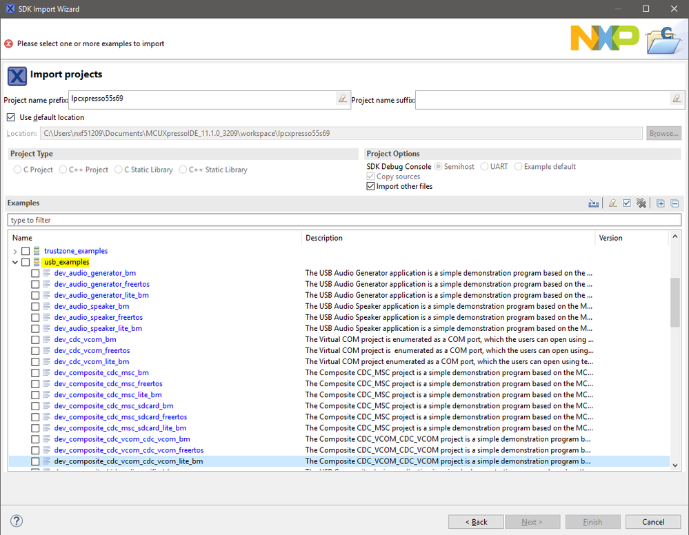

For a future application, we need to have USB high speed interface with LPC55S69 or equivalent chip.
We could not find any example in the SDK. Can you provide any information that points us in the right direction?
  • Do you offer any example for using a custom, user defined class to work with Win USB
  • Do you provide examples for Mac / Linux?
Thank you.

The SDK has several examples using the USB. There are plenty to get you started using as a device or host.
For the questions regarding the signed drivers:
https://community.nxp.com/thread/357509
The SDK can be downloaded for Linux/MACOS. This needs to be selected when building the SDK on our website.
Sabina

Well, I was able to do what i want finally.
It was long, but doable.
In my case i started with the dev_usb_cdc_acm_lite_bm SDK example, and started to read, simplify, rewrite things, compare with USB specification, and slowly it all made sense.
In my case, i was able to reach 15MB/s on a user defined class using bulk transfert
