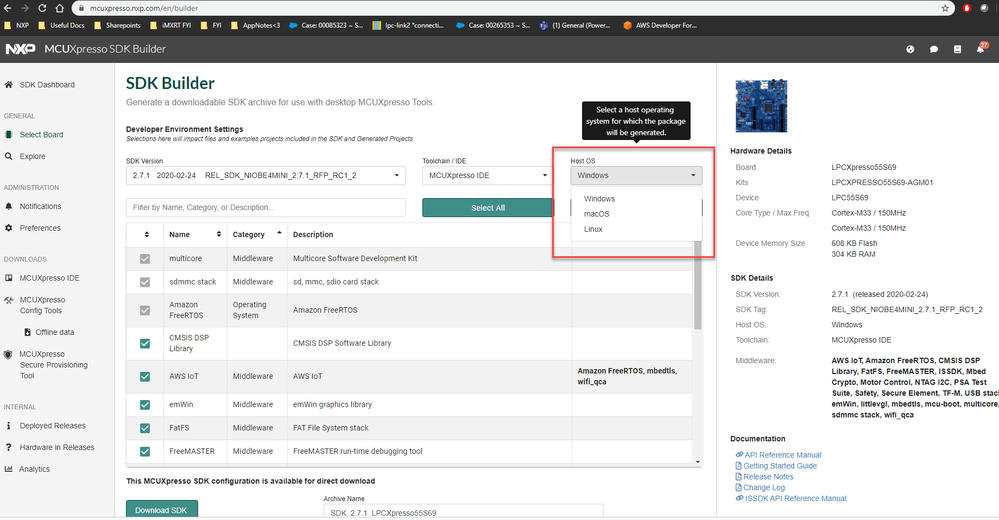

The SDK has several examples using the USB. There are plenty to get you started using as a device or host.
For the questions regarding the signed drivers:
https://community.nxp.com/thread/357509
The SDK can be downloaded for Linux/MACOS. This needs to be selected when building the SDK on our website.
