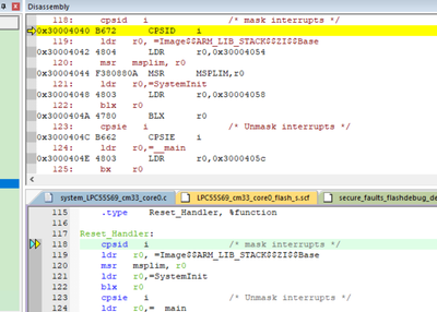

 aflter load .elf, I can use the cmd "PC = 0x30004040"  ,set pc
 but when run to "PUSH {r7,lr}", whitch is the first instructions in “SystemInit” .it make a hardfault, I can see the "SCB--CFSR" is 0x0010, that's is a stack overflow.
  Can't core0 run in SRAM0~4?  It only can run in flash/Rom/SramX?

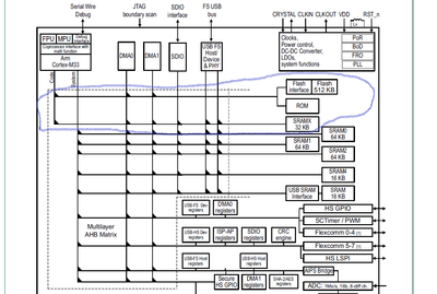

xiangjun_rong
Hi, LiYou
Pls refer to the following Fig in Chapter 1 in UM11126.pdf, the Flash/ROM/SRAMX are connected to code bus directly, so core can execute code saved in Flash/ROM/SRAMX directly.
If you want to execute code in SRAM0, SRAM1,SRAM2, SRAM3, I suppose it is okay, but you have to configure the MPU module.
You can refer to the AN12423.pdf on how to set up MPU.
https://www.nxp.com.cn/docs/en/application-note/AN12423.pdf
Hope it can help you

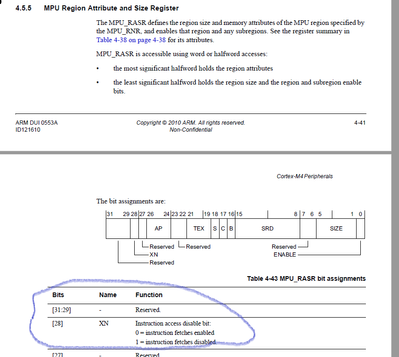

frank_m
Senior Contributor III
I suppose the X flag must be set than, to allow code execution from the MPU section.
I did not use it myself, the MPU only serves to separate "safe" and "non-safe" data in my company's applications (running on Cortex M3/M4 MCUs).
Anyway, I don't see a specific advantage of executing code from RAM - except for IAP access to the application Flash bank. The code must be loaded from Flash anyway, and both Flash and RAM are internal, so no security issue.
Or am I wrong here ?
7,195 Views
xiangjun_rong
Hi, Frank,
How are you!
As the screenshot, the XN bit determines if you enable a space to be instruction fetch enabled or disabled.
Because I have not the Cortex-CM33 user guide, I attach the Cortex-M4 user guide.
XiangJun Rong
7,190 Views
