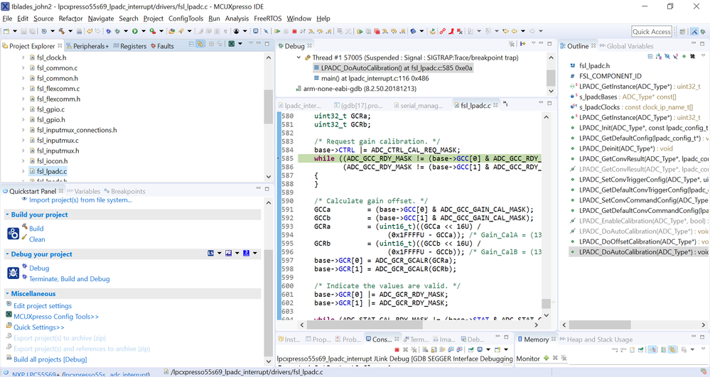

hi XiangJun Rong,
i added the code into both interrupt and polling code, but when i ran it, it keep getting stuck on this while loop right here.
(See below screen capture).
Please advise!

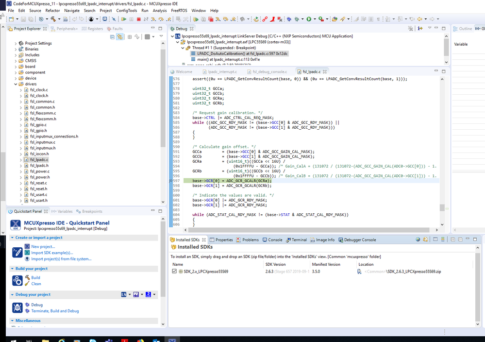

I think you can download the latest SDK package based on LPC55S69 SDK_2.6.3_LPCXpresso55S69.zip and use the latest MCUXpresso tools ver11.0.1, and load the lpadc_interrupt example. You do not need to change anything, it do calibration exactly  without any modification.
I have tried to debug, this is the result. of course, I can pass the calibration.
XiangJun Rong

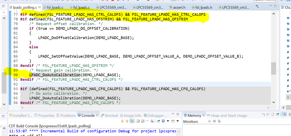

xiangjun_rong
Hi, HyMai,
I have tested the ADC calibration for LPC55S69, the calibration code works fine.
It is okay if you set the following calibration.
//#define DEMO_LPADC_DO_OFFSET_CALIBRATION false
#define FSL_FEATURE_LPADC_HAS_CTRL_CALOFS 1
#define FSL_FEATURE_LPADC_HAS_OFSTRIM 1
#define DEMO_LPADC_DO_OFFSET_CALIBRATION true
After you modified the code, the macro is like this:
 * Definitions
#define DEMO_LPADC_BASE ADC0
#define DEMO_LPADC_IRQn ADC0_IRQn
#define DEMO_LPADC_IRQ_HANDLER_FUNC ADC0_IRQHandler
#define DEMO_LPADC_USER_CHANNEL 0U
#define DEMO_LPADC_USER_CMDID 1U /* CMD1 */
#define DEMO_LPADC_VREF_SOURCE kLPADC_ReferenceVoltageAlt2
#define DEMO_LPADC_OFFSET_VALUE_A 10U
#define DEMO_LPADC_OFFSET_VALUE_B 10U
