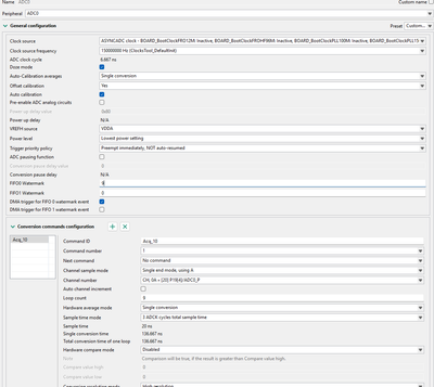

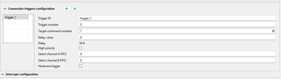

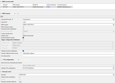

I'm trying to use ADC receive 10 data a time and doing average.
This is almost the same from the adc example, in which the adc acquire 3 samples and do averaging.
The main difference is I used config tool -> peripherals to setup my ADC and DMA, here is the parameters:
ADC:
DMA:
And I copy the code from the example "lpcxpresso55s69_lpadc_dma":
g_DmaTransferDoneFlag = false;
LPADC_DoSoftwareTrigger(ADC0, 1UL);
while ((LPADC_GetStatusFlags(ADC0) & RESULT_FIFO_READY_FLAG) == 0UL)
PRINTF("1\r\n");
PRINTF("2\r\n");
DMA_StartTransfer(&DMA0_CH0_Handle);
while (false == g_DmaTransferDoneFlag)
PRINTF("3\r\n");
uint16_t adc_val = (uint16_t)(g_avgADCValue & ADC_RESFIFO_D_MASK);
if (adc_index < sizeof(adc_data_buffer)/sizeof(adc_data_buffer[0])) {
adc_data_buffer[adc_index++] = adc_val;
The issue I have is that the code is stuck at
PRINTF("3\r\n");
unless the "FIFO0 WATERMARK" in the peripheral was changed to 0.
I tried to compare the auto generated pheripherals.c with the ADC_Configuration(void) in the example but no luck.
Did I miss some codes, or mass up with some setup?

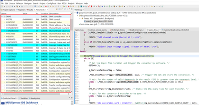

This proves that DMA is not worked.
This may be due to ADC not being configured correctly or DMA not being configured correctly.
I think you can check the adc dma registers between sdk demo and your code in debug moed.

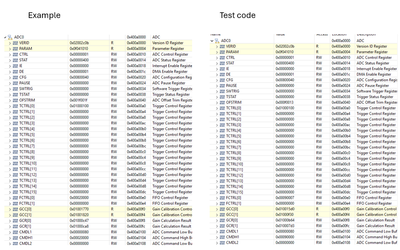

waliwalabo
Hi Harry,
Thanks for your suggestion.
I compared the DAM and ADC. I thought my DAM was almost identical to the example and found something interesting in ADC's register:
I took the screen shot when my firmware stuck at the while loop, and FCTRL[0] = 0x00090007.
According to the manual, bit 0:4 is FCOUNT. I tried different watermark like 6 or 8 and when it got stuck, FCOUNT is always smaller than watermark by 2.
Then I changed the watermark to 2 and my code finially work.
So it seems that if the watermark is larger than 3, the FIFO will never receive enough data, no matter what setup I used in config tool.
I change the watermark and SAMPLE_COUNT in the example and it stops working as well.
Did I miss something in the ADC configuration? I don't think this fifo cannot hold more than 3 words. I found FIFOSIZE in the UM and compared with the register, I can confirm that the fifo size of the example and my code is 4. Maybe this is the reason of all the issues but I didn't find the place to change it in the config tool.
What do you think?
