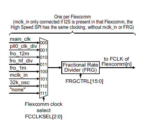

Hi, Francis,
This is the fig of the uart clock:
I think it is correct that you get 2K baudrate.
You use OSC32K as the uart clock source.
Flexcomm Interface clock = (FRG input clock) / (1+(MULT / DIV))
For your case, the DIV=255, the MULT is zero, so the FlexComm0 clock is the 32K OSC.
This is baudrate formula:
baud rate = [FCLK / oversample rate] / BRG divide
For your case, the oversample rate is a fixed value 16, the BRG is 1(which you set up BRG as zero), so the uart baudrate is
32K/16/1=2K.
Hope it can help you
XiangJun Rong
