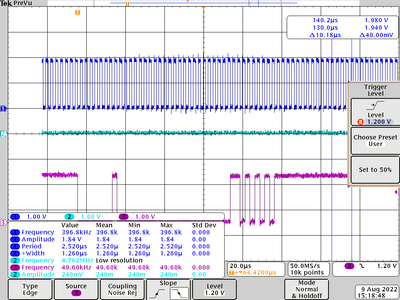

On the LPC55S6x I am getting a response timeout after CMD 8 for the SD card is called.
It does not seem to be a hardware issue, because I used an oscilloscope to verify that a response is sent.
The dark blue waveform is the clock, and the dark pink is the response.

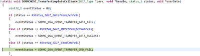

I have tested the sd card interrupt example and it did not work. As yo u cna see, the program does not continue after CMD 8. The sd card cannot initialize, so I doubt any of the examples can work. It stops at the function ProbeBusVoltage.
