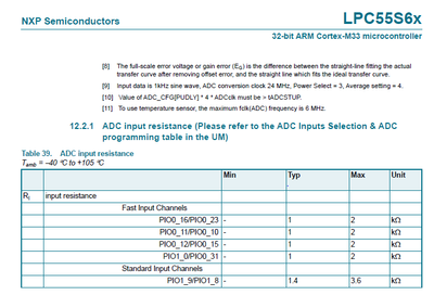

I cant find the input impedance spec of the built-in ADC of LPC55S69JEV98K
checked both datasheet and UM, please advice.
Also looking for the tolerance/specification of the internal Voltage-reference rail.
Thanks!
1,535 Views
ZhangJennie
ADC input resistance is documented on DS. see below. Is that what you are looking for?
