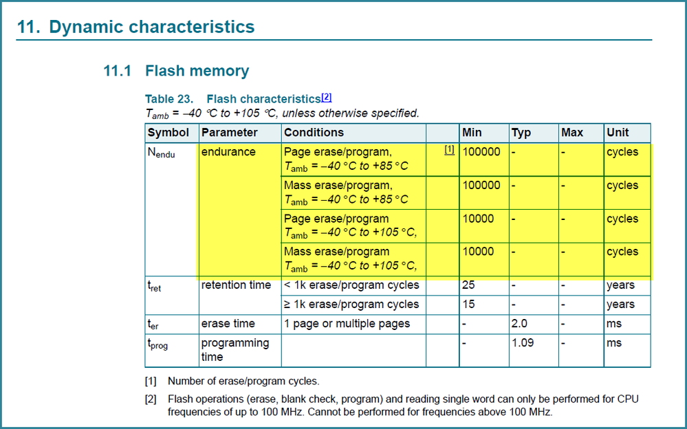

Hi !
Unfortunately flash memory can be written by 512 bytes chunks only.
But I need to sabe small 16-128 bytes chunks and I can see I can read modify and write the same page several times.
LPC55S69 flash memory has erased state as 0x00 and each bit can be programmed to 1 on time.
So I can program page several time but I can only modify bit 0 to bit 1 and not wise versa what is typical for flash memory technology.
But each type of memory have clear limit of NOP operations what can be done on one page before Erase must be executed ( What's NOPs of NAND  as example ).
What amount of NOP's are specified for that flash memory what is part of LPC55S69 MCU ?
Eugene

ZhangJennie
Eugene,
I guess you ask Flash endurance parameter. see below table, it is extracted from LPC55S6X datasheet.
Jun Zhang

EugeneHiihtaja
Senior Contributor I
Hi !
Not it is not endurance , this is partial write e.h how may times you can write one 512 pages before erase.
e.g read whole page  ( if need )  fill some area and write back. During this operation you can change only bits from 1 to 0 or may be like in your case 0 to 1 only.
But each type of memory must have this value, It can be 1 as well. Too much overwrite cause retention problems for sure.
OR I can write 512 one time and after that only erase must be done. In other case you might not garantie data retention at all.
But NXP should specify this value. In other case is very difficult to implement any file system on top of LPC's flash memory.
Eugene
