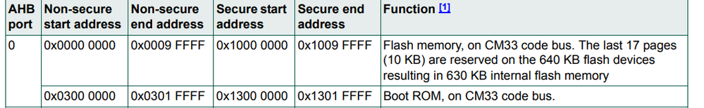

MCU has boot rom and secure boot rom what used for ISP, secure boot and etc.
Does it possible to know what exact SRAM area they use in worst case for all of those operations ?
At list it would be nice to know what exact ares  are not used in any booting flashing case.
I need to pass over reboot few KB of data and need to know what SRAM can be corrupted due usage if it by bootrom operations.
Eugene

Hello Eugene,
The area used for the operations mentioned is the following area described in the table:
Sabina

Hi Sabina !
This is ROM and flash memory only. When bootrom is executed , it use some SRAM areas for variables and for peripherals.
are the specified somewhere ?
Eugene

Hello Eugene,
The peripheral addresses and sram address are specified in same table as I listed above in the user manual. However it is not specfied( as in some Kinetis families), what is being used during the execution of the bootrom. In addition this area of sram should be freed once the the bootrom execution is finished and jumps to the application.
Sabina
