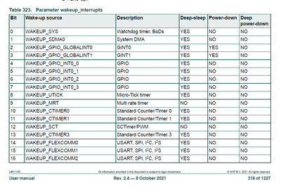

Also as a bit of documentation feedback, table 323 lists WAKEUP_GPIO_GLOBALINT0/1 as wakeup interrupt sources. This terminology isn't used anywhere else in the manual - GINT stands for Grouped Interrupt everywhere else. The software documentation seems to be written by a different group and I've noticed they have their own unique interpretation of some nomenclature.

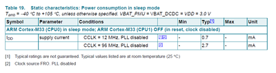

This is the current spec in sleep mode for LPC55S69 copied from data sheet which can be downloaded from the website:
https://www.nxp.com/products/processors-and-microcontrollers/arm-microcontrollers/general-purpose-mc...
As you can see that the current spec is dependent on the clock frequency, when the cclk is 12MHz, PLL is disabled, the current spec is 700uA.
Regarding the signal WAKEUP_GPIO_GLOBALINT0/1, as the following Table 323 I copied from UM11126.pdf, you are right.
The WAKEUP_GPIO_GLOBALINT0 is signal GINT0.
The WAKEUP_GPIO_GLOBALINT1 is signal GINT1.
For detailed inf, pls refer to Chapter 21: LPC55S6x/LPC55S2x/LPC552x:Group GPIO Input Interrupt (GINT0/1)
