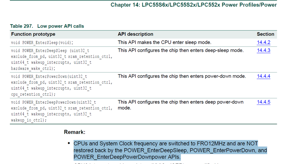

In Datasheet is written :
"Power Library in SDK sets the flash wait states based on the frequency selected."
When MCU is exit from PowerDowm mode it is clocked by using FRO_12Mhz,
but in SDK examples you still call BOARD_BootClockFRO12M() after wakeup.
Can it be so that only line  SystemCoreClock = BOARD_BOOTCLOCKFRO12M_CORE_CLOCK;
is need ?
All other setting is done by Powerlib already.
Is this so ?

Hi, Eugene,
I think you are right, after sleep/deepsleep/powerdown, the cpu core clock is restored to FRO_12MHz, so the code line
BOARD_BootClockFRO12M(); is unnecessary. Because DEMO_PowerDownWakeup() is called after waking up.
Hope it can help you
XiangJun Rong
