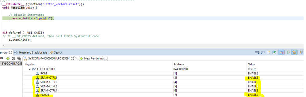

diego_charles
Hi Eugene!
Thank you for your patience,
On  the beginning of your application their controllers are already enabled by default, as we can see
on the following screenshot
Diego

EugeneHiihtaja
Senior Contributor I
Hi diego.charles‌ !
I can see in UM, default value for AHBCLKCTRL0 register is specified. It means SRAMn clocks enabled somewhere in bootrom. In this case is difficult to  trust if clocks always will be enabled there ( or disabled/enabled again ) and SRAM retain over reboot in next versions of bootrom if any.
By the way, I haven't found any clock enable for SRAM X area. Is this type of SRAM  always ON or it is just in other registers ?
But I think it is good idea to have clear spec. in what states registers remains after bootrom.
Eugene
2,193 Views
diego_charles
Hi Eugene,
You should not worry about the SRAM X areas, they are enabled by default.
As you know, you could control their retention state during low power modes using the sram_retention_ctrl register.
Diego
