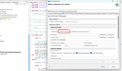

So i think you can try to
Use your debug probe’s Connect under Reset on connection option.
In MCUXpresso IDE,
Harry

Hi Harry,
That didn't seem to change anything. I tried with one of the boards I haven't pulled the crystal from yet, that I bricked with the bad firmware load, and it's still unable to connect. I've tried similar settings for the P&E interface.

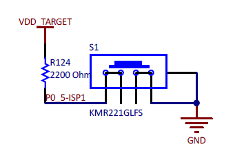

I think you  can put the chip into ISP mode and then use ISP commands to erase the first 1KB or 10KB of the flash to corrupt the firmware header, preventing the chip from jumping to the firmware, and then connect using a debugger.
The isp pin is PIO0_5.
And then use blhost command.

Hi Harry,
That might work for the LPCxpresso55S69 board, but it doesn't help with any of my own boards. With MON08 and BDM debuggers on older MCUs there was always a way to mass erase the flash no matter what was loaded - it'd go into debug mode right out of reset. Is SWD just not capable of that?

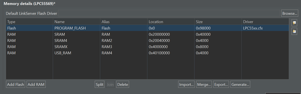

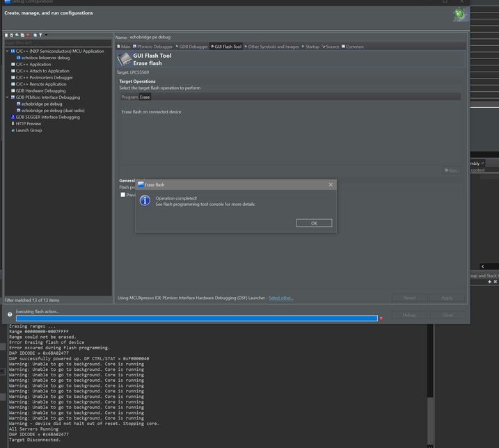

There's definitely something more going on than pins getting reassigned. Debugging in MCUXpresso has always been very unreliable for me and I'd love to get to the bottom of it. It was working fine for the first half of the day. I made a minor change (enabling the FreeRTOS vApplicationMallocFailed() hook and defining a function with __BKPT(0)) and haven't been able to load and debug anything since, with either the Cyclone or LPC-Link2.
The connection is fine. And in fact I'm able to connect with PROGACMP and erase the device, and verify that it's erased. It's coming back all 00 when on most devices I expect FF, so I don't know if that's right, but it's at least passing the blank check.
Even with an erased device, I can't do anything with it. Here's what I get with the GUI flash tool. There are a few things going on here - first, the dialog indicates it completed when the log shows that it failed. And from the log you can see that it's got the wrong range, or at least not the complete range.
I can also use the Cyclone to program a known-good image and the device runs, but I still can't do anything from MCUX.

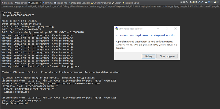

OK, I'm making some progress. I eliminated several things - tried a new board, another debug interface, a brand new cable, and tried using the LPCxpresso board as well. None of them would get past the "Range could not be erased" error.
Now, when I said the erase range wasn't correct, or wasn't complete, that's because this project has a bootloader image included at 0x9b000 with some reserved space at 0x9a000 for bootloader commands. It wasn't showing the high range.
So to check if it had something to do with that high range, I loaded the hello_world sample project and it erased and programmed just fine. It's not a hardware problem at all.
Next, I switched over to the bootloader's own standalone project. This project has been untouched for a year or two. It links as a standalone application so that it can optionally be loaded on a blank device and will pick up its firmware update from external SPI flash, so it has a vector table of its own.
I tried debugging it with the P&E debug configuration that hasn't been touched in ages. It failed with the same error:
Erasing ranges ...
Range 00000000-00001FFF
Range could not be erased.
Note that the 0000-1FFFF range only reflects the vector table and not the code. To test if this was a problem with non-contiguous memory areas, I created a new memory section called UNUSED_FLASH that occupies the rest of flash and used FILL(0x55) to give it some data. When it's linked, it shows it 100% full:
Memory region Used Size Region Size %age Used
VECTOR_FLASH: 304 B 1 KB 29.69%
COMMAND_FLASH: 60 B 512 B 11.72%
SVECT: 4 B 4 B 100.00%
UNUSED_FLASH: 633344 B 633344 B 100.00%
PROGRAM_FLASH: 9880 B 10236 B 96.52%
SRAM: 9528 B 16 KB 58.15%
USB_RAM: 0 B 16 KB 0.00%
Finished building target: LPC55S69_Bootloader.axf
I launched it again, with the same problem. It shows that it's erasing only the 0000-1FFF range, and it fails. So whatever's going on seems to be related to how it determines which ranges to erase and how it verifies the upload.
This seems to be a recent thing (I'm running MCUX v25.6 build 136) and my hunch is that it feels like all of the other unreliable, quirky debug behavior I've encountered with MCUX because the IDE just has bad integration with gdb. Here's how the session ends:
PEmicro GDB Launch Failure : Error during flash programming. Terminating debug session.
PE-ERROR: Error downloading to the device. Terminating debug session.
Disconnected from "127.0.0.1" via 127.0.0.1. Disconnection by port "52065" from 6225
Disconnected from "127.0.0.1" via 127.0.0.1. Disconnection by port "52070" from 7225
INFO: DAP IDCODE = 0x6BA02477
Target Disconnected.
Except it doesn't actually end - I can hear the CPU fan kick on and arm-none-eabi-gdb.exe consumes 100% CPU time on one core. Here's gdb's output:

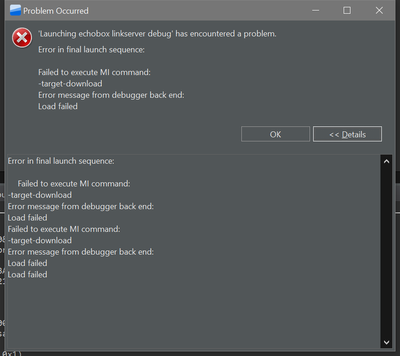

611,663 27interpreter-exec mi2 "-break-insert -t -f main"
611,788 28-list-thread-groups
615,695 &"Error finishing flash operation\n"
615,695 26^error,msg="Error finishing flash operation"

615,766 &"warning: Exception condition detected on fd 528\n"
And if you'll recall from my last message, the GUI flash tool similarly doesn't properly register fault conditions.
For now I'm up and running by excluding my bootloader from the .ld file.
Let me know what you think about the non-contiguous memory erase/verify problem. And I would be happy to help your developers with testing fixes to the gdb integration because that's been a constant headache for years.

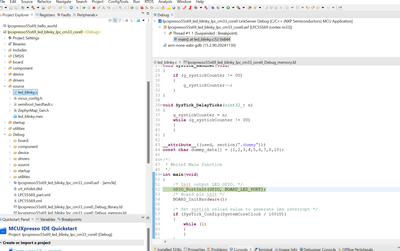

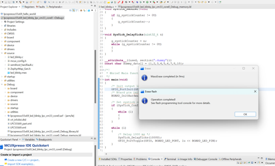

One more update before I give this a rest for the evening. I'm able to reproduce the problem, at least for P&E, by modifying the led_blinky demo. This not only fails the "Erasing ranges" operation, it also frequently crashes gdb.
To reproduce, load up the led_blinky demo for the LPCxpresso55S69 board. Disable the managed linker script. Add some dummy data:
__attribute__((used, section(".dummy")))
const char dummy_data[] = {1,2,3,4,5,6,7,8,10};

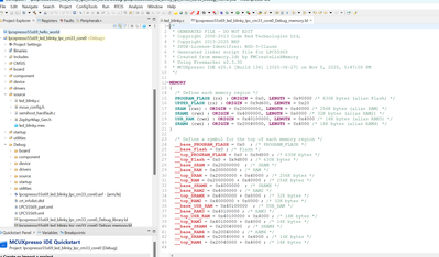

Edit the .ld files to add a high section:
MEMORY
/* Define each memory region */
PROGRAM_FLASH (rx) : ORIGIN = 0x0, LENGTH = 0x90000 /* 630K bytes (alias Flash) */
UPPER_FLASH (rx) : ORIGIN = 0x9d600, LENGTH = 0x20
SRAM (rwx) : ORIGIN = 0x20000000, LENGTH = 0x40000 /* 256K bytes (alias RAM) */
SRAMX (rwx) : ORIGIN = 0x4000000, LENGTH = 0x8000 /* 32K bytes (alias RAM2) */
USB_RAM (rwx) : ORIGIN = 0x40100000, LENGTH = 0x4000 /* 16K bytes (alias RAM3) */
SRAM4 (rwx) : ORIGIN = 0x20040000, LENGTH = 0x4000 /* 16K bytes (alias RAM4) */
 .dummy : ALIGN(4)
KEEP(*(.dummy))
. = ALIGN(4);
} > UPPER_FLASH
Build and upload. Twiddle dummy_data and one of the timer constants to make sure the code changes. Recompile and upload again and it fails.
Scott

There are at least two different issues here. The blinky demo I shared illustrates the problem with the P&E driver. I've talked to P&E and they believe it's a problem with the erase function in their driver, which they're working on. The workaround for now is to set it to erase the whole chip rather than having it erased only the used areas.
The other problem doesn't appear with a new project. I've found that the underlying problem is that the memory definition MCUX had for the LPC55S69 was wrong:
It should be 0x9d800, not 0x98000. This is from a project created two years ago. The problem has been fixed in MCUX at some point since then, but the project was created with the incorrect setting and carried that over. If there was any mention of this in the MCUX release notes, I didn't see it.
Now, what I see as an additional problem is the lack of any meaningful error message. This should generate some kind of warning that it's trying to program outside of the defined memory range. Instead we just get a generic failure:

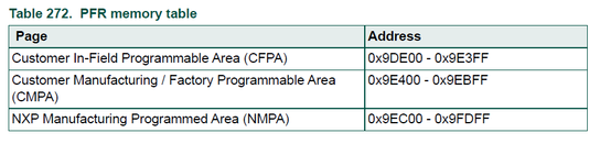

The original cause of all of this mess seems to have been bad documentation:
The LPC55S69 uses 512-byte pages so 16 pages is 8 kB and the above cannot be correct. What's worse is that someone has looked at this and corrected the figure from 17 pages to 16 but didn't correct the size:
If the memory map had simply stated the upper bound of the non-reserved flash area all of this could have been avoided. As it is, the datasheet still does not make the upper bound clear. If we subtract 16 pages from 0x9ffff we get 0x9dfff for the top of flash. If we subtract 10k we get 0x9d7ff for the top. The PFR documentation shows that the PFR starts at 0x9de00:
Nothing in the datasheet would seem to account for the space between 0x9d800 and 0x9de00.
The usable program memory range is one of the most basic parameters needed to program any MCU and the datasheet manages to obfuscate it so thoroughly that both NXP and P&E got the implementation wrong.
