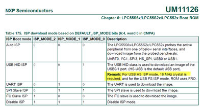

HI jean_b
USB1 ISP mode reqires 16Mhz external crystal. This is must. Otherwise USB1 ISP can't work.
See statement in UM
Have a nice day,
Jun Zhang

jean_b
I have tried using the dev_hid_generic example for LPC55S69 with the configuration for USB1. It unfortunately does not work, while it is doing fine on a EVK board I just acquired.
It looks like it is an issue with the hardware. While comparing my board to it, the main difference I can see is the crystal, I have a 32MHz crystal while the Evaluation Board has a 16MHz one.
Can this prevent the USB HS from working from the Bootloader ?
Thank you,
Jean-Baptiste
4,230 Views
ZhangJennie
HI jean_b
See statement in UM
Have a nice day,
Jun Zhang
