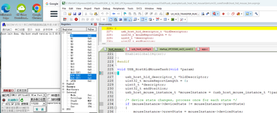

ding001
SDK           :  SDK_2_16_000_LPCXpresso55S69,
example  :     usb_host_hid_mouse
tool           :     KEIL

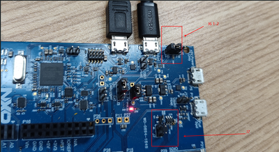

The Jumper settings:
J6 1-2 and J7 open for high speed mode
like:

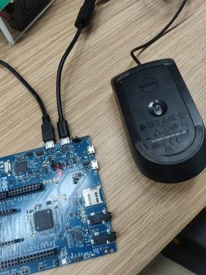

The mouse is not work:
