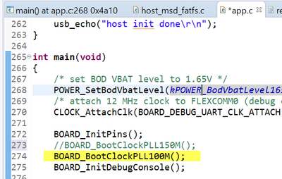

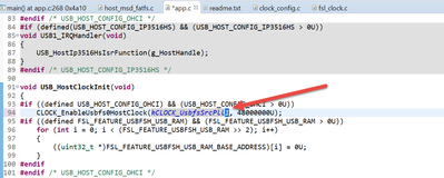

ZhangJennie
 I tested PLL0 100M on my side. this code can't run successful on my side.
by checking the the USB host clock init code, I change
CLOCK_EnableUsbfs0HostClock(kCLOCK_UsbfsSrcPll1, 48000000U);
to
CLOCK_EnableUsbfs0HostClock(kCLOCK_UsbfsSrcPll0, 48000000U);
fix the issue
the output on uart terminal is all successful.
Have a nice day,
Jun Zhang

yingbohu71
I just tried your suggestion:
1. changed the clock to 100M
BOARD_InitPins();
BOARD_BootClockPLL100M();
BOARD_InitDebugConsole();
2. changed the USB FS clock to use kCLOCK_UsbfsSrcPll0
#if ((defined USB_HOST_CONFIG_OHCI) && (USB_HOST_CONFIG_OHCI > 0U))
#if ((defined FSL_FEATURE_USBFSH_USB_RAM) && (FSL_FEATURE_USBFSH_USB_RAM > 0U))
for (int i = 0; i < (FSL_FEATURE_USBFSH_USB_RAM >> 2); i++)
((uint32_t *)FSL_FEATURE_USBFSH_USB_RAM_BASE_ADDRESS)[i] = 0U;
#endif
#endif /* USB_HOST_CONFIG_OHCI */
I still have the same issue. I believe I am using '1B' version of the MCU. SYSCON->DIEID->REV_ID is 0x1
Could you share with me the log output on your side?
