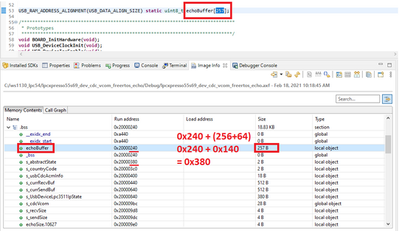

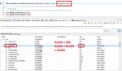

mditto1
Jun,
Just to be sure, I created a fresh project from sdk example dev_cdc_vcom_freertos using SDK 2.9.0 and copied your two files exactly.  I also edited usb_device_config.h to use HS instead of FS.  This has the behavior I described (lower, but not zero, failure rate on i.MX8).
You suggested trying:
USB_RAM_ADDRESS_ALIGNMENT(USB_DATA_ALIGN_SIZE) static uint8_t echoBuffer[257];
But this does not change the alignment of echoBuffer.  It is still at address 20000240.
Note that removing the alignment restriction:
static uint8_t echoBuffer[256];
Does not guarantee that echoBuffer will misaligned.  In practice I found that it gets placed at 2000087C (word aligned but not 64-byte aligned).  But the behavior does not change - there is still a low rate of failures.

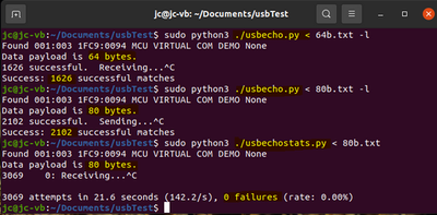

Unfortunately, We don't have an i.MX8 to test exact same scenario but here are my results on both scripts with echoBuffer (256 or 257) aligned in RAM):
echoBuffer aligned in RAM, 256 size
echoBuffer aligned in RAM, 257 size
