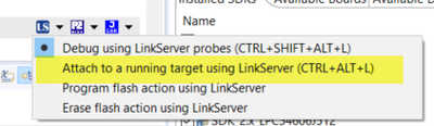

The secure boot *is* working
The problem is the app is crashing quickly in secure boot mode, and it is  working fine in non secure boot mode
I 'm looking for a way to debug the app in secure boot mode, so that i can check why it crashes and fix it
It's fine if i have to lower the overall security temporarily
Any help would be appreciated

7,993 Views
Hello trescurieux,
How do you know "The secure boot *is* working" ?
If the secure boot configure well, and program a SB2 file (APP+singed+security), it can work well.
And at this time, also can debug(Do not erase,program, just debug).
Alice
7,990 Views
trescurieux
Thank you for you reply
Indeed, i will retry and disable erase/program in the debugger, that might be the main issue
Tres
7,979 Views
Yes, it can't erase and program, you can also test Attach function to debug.

trescurieux
Indeed the "attach to running" method worked
Just need to figure out why it crashes now
Thank you
