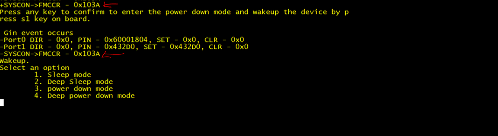

Sabina_Bruce
Hi Eugene,
So after thoroughly checking what happens. I found that when the command  CLOCK_SetFLASHAccessCyclesForFreq(32768U); is executed it rewrites the value. So to force that the prefetch bit is not over written I simply added that 0x30 to enable the prefetch bit.
Then when this gets execute it will not rewrite the bit.
Once I execute the example you provided I get the following:
Here it won't be necessary to add the following line since it will be done in that function.
SYSCON->FMCCR |= 0x30; // enable prefetch, acceleration is enabled by default
Sabina

EugeneHiihtaja
Senior Contributor I
Hi sabinabruce‌ !
So you also see drop of prefetch bit and DIR registers.
I think usage of CLOCK_SetFLASHAccessCyclesForFreq(32768U) is not mandatory. MCu can go to PowerDown from any clock scheme.
So I should recover it in my code in common case.
Is this so ?
Eugene
5,010 Views
Sabina_Bruce
Yes it looks like it needs to be recovered after waking up from power down. This can be implemented in another location of your preference or as I have done above.
