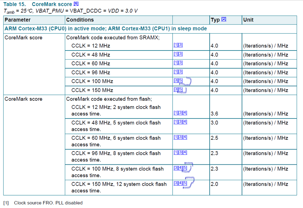

in DS Table 16. , exists notice [5] PLL enabled but it is not set for any raw in this table.
I think this is typo and should be applicable when CCLK is 100 or 150 Mhz.

From Table 15, you are right, the LPOC55S69 use PLL to generate 100MHz and 150MHz clock which are marked by [5].
Regarding peripheral power consumption in power mode, the data sheet only gives the power consumption in active mode rather than in low power mode, because each peripheral consume less power consumption than that of on-chip SRAM.

Yes table 15 is correct, but table 16 is not.
br,Eugene

The Table 16 does not mention the Note5, but it lists the Note5, I think it is a typo, I agree with you.
