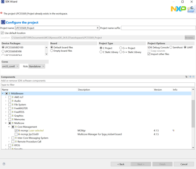

When creating a new project from scratch, I add the mcmgr module using the wizard. Then after doing so I run into Undefined Reference Errors.
#include "mcmgr.h"
(void)MCMGR_EarlyInit();
(void)MCMGR_Init();
Simply calling either of these two functions creates many undefined reference errors.
Again this is from a new file, I've checked the includes section in the properties and the mcmgr folder is selected, and I can't find any difference between the properties of this project and one of the mcmgr sdk examples.

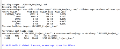

Harry_Zhang
Hi @AveryDauben
I have selected the Multi Core Manager.
This can be compiled successfully.
You can test it.
And i think you can also refer to the multicore manager demo.
