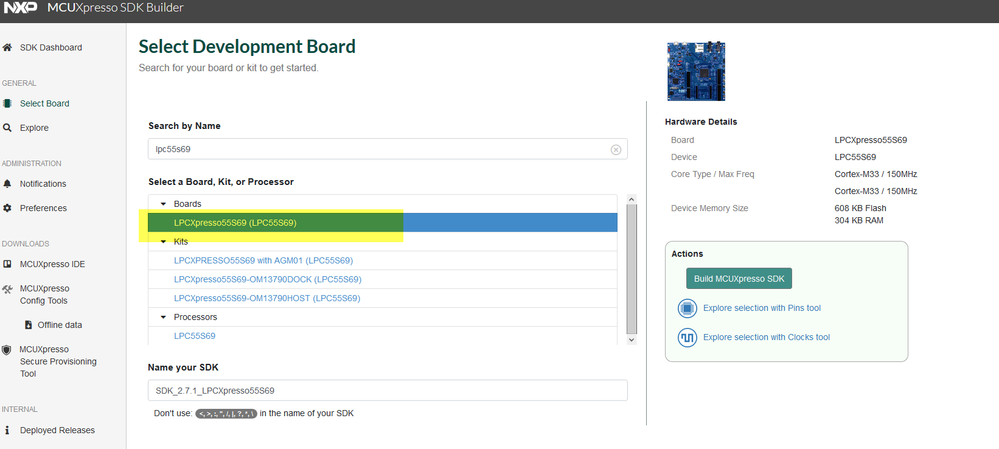

Hello John Edwards,
Please download SDK, there is a Group GPIO input interrupt demo:
Download from:
https://mcuxpresso.nxp.com/en/select
Hope it helps,
Alice
